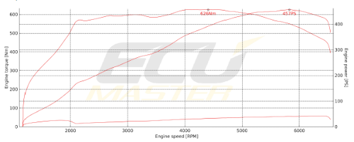

LT1 engine:
  • Power: 450 HP
  • Torque: 620 Nm

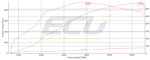

LT4 engine:
  • Power: 680 HP
  • Torque: 940 Nm
