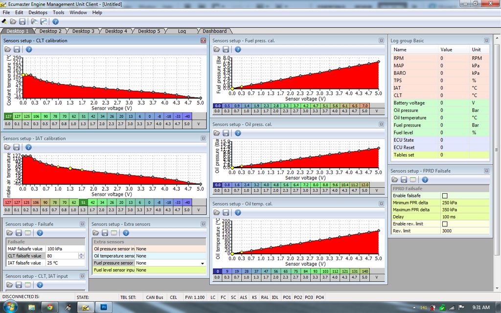

Please make a small improvement, though. Margins and some window positions are not retained when re-opened.
This is before saving template:
After closing program and re-open: Coolant calibration table moved to right a little, and margins in tables and log group change.
Re: EMU Software 1.1 BETA 3 is already available!
Hi Kurt!
The bug you have found is already fixed and the fix will be available in Beta 4. However you need to save the correct desktops again (the splitter position wasn't save to desktop file)

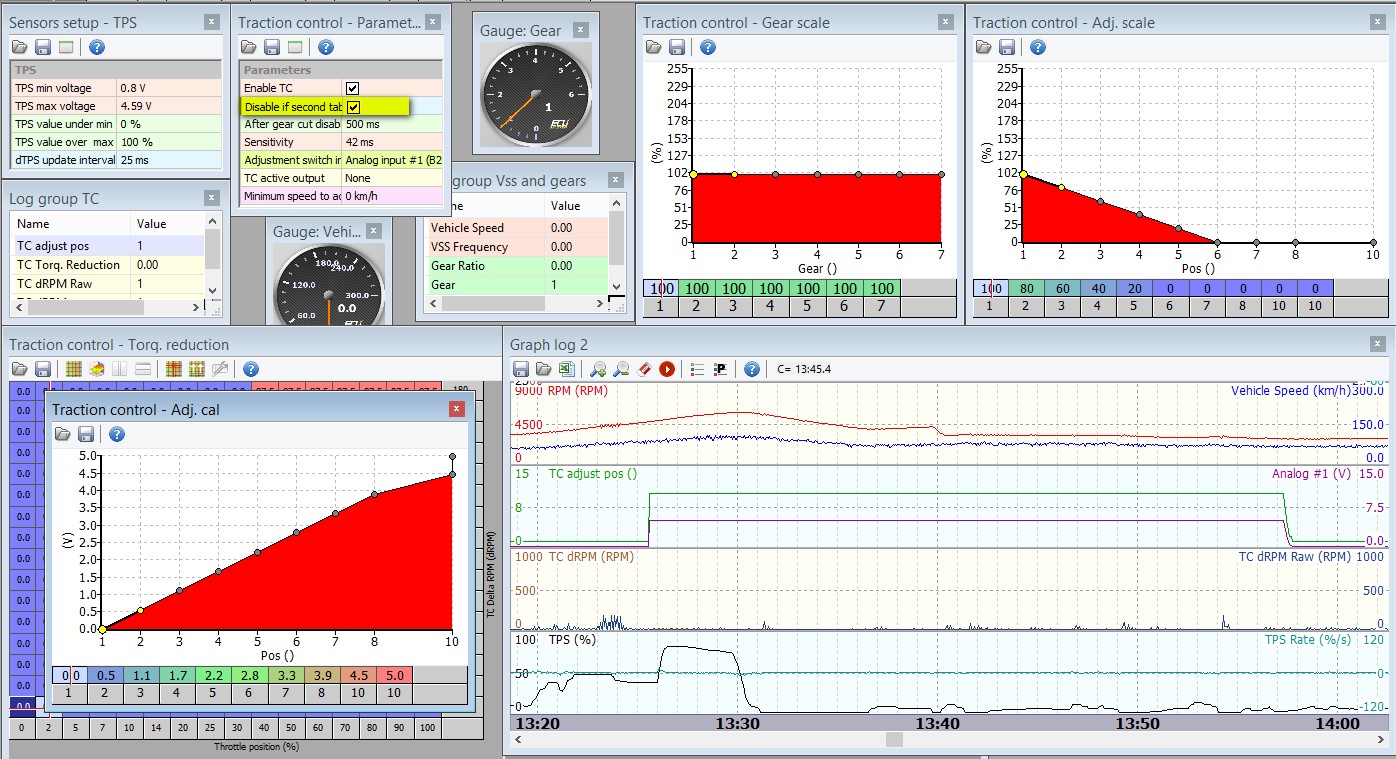

hi,
in traction control functions "Disable if second tables set" don`t work any more, i configured adj. scale and selected the same input as table switch so this is not rly a big problem

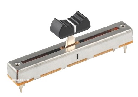

i already ordered 10k linear potentiometer to have better control
