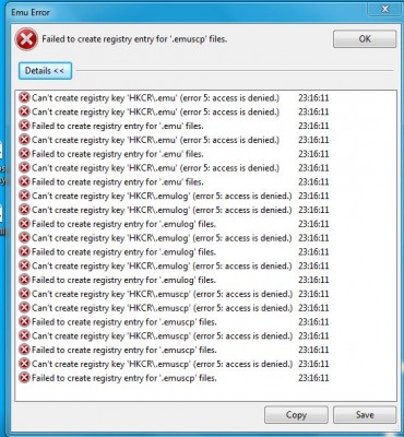

Is anyone experiencing the same error when you open the program? Didn't get this on the previous versions.

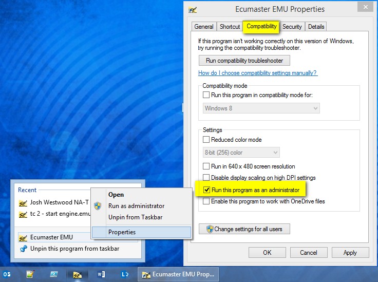

Re: Version 1.112
Looks like you do not have adiminstrator rights to register file extension in registry.
Try to start application as administrator.

Re: Version 1.112
I got it on both my laptops, but not logged in as admin either.

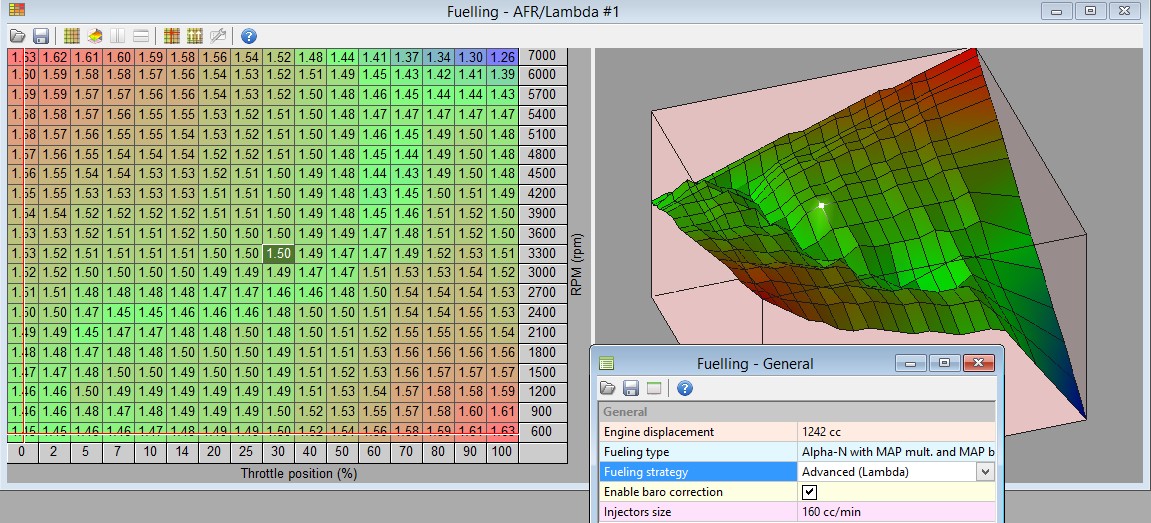

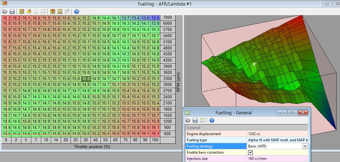

if you can, try :ATS_Scott wrote:I got it on both my laptops, but not logged in as admin either.
and to support , division function don`t works for me
open AFR based map change fuel strategy to advance and divide all by 1.47

Re: Version 1.112
Thanks for the tip, that did the trick for me.

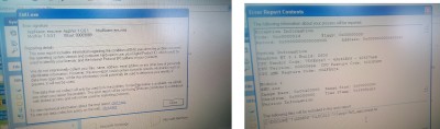

I updated from 1.1 and it do not work , try to uninstall put 1.1 again - no problem but 1.112 do not work on XP , here is the error
Re: Version 1.112
I had the same issue and running as administrator fixed it.
Re: Version 1.112
This error is while logged as administrator , I check this twice

In next version the application will force the system to run as administartor. I think it helps.
