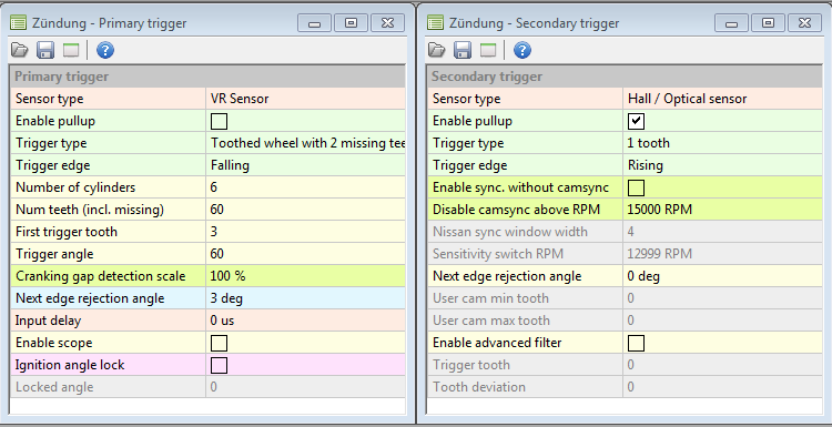

Re: Ecu State at Cranking Problem
So here is the trigger scope.
I have check the cam position this is ok.
The hall sensor from cam is at the same position like before i change the cams.
When i start in wasted spark mode the ignition angle goes as i cranking mode but the injection time is 0ms and the injectors make once splash.
i found some faltly parameters. Under engine start, crancing threshold is 200 and has to be 400 and engine stall rev limit is 200 an has to be lower, try 60.
In your scope i can see, that your cabeling is wrong, you have to change the +/- of your primary trigger VR sensor.
Your engine stall revs are set to 200!!!
That is the reason. The EMU use this value to knows if the RPM are high enough to crank.
So you need over 200RPM to shift into cranking state.
Set this value to 50-60...

I can see it in your scope! The first signal after the gap has another time gap as the others.
I have switch den cable. And now the car dosn´t start and the trigger signal is the same.
Send two scopes with falling and rising edge..
And fix this settings!!
The other problem is already solved.
Now is the first trigger ok.
Which setup for the second trigger is the right one?
The motor starts with rising and falling
