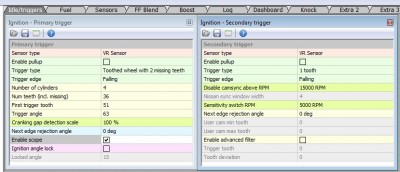

would it be possible someone has a startup/base map for a 3sgte with st215 crank and cam senser ,with COP , 1000cc hks top feed injectors .
or just setup for primary ignition and cam please .
Re: ASk for 3SGTE basic settings
This is what I have been using for Gen4 3sgte. Should be same or similar for 3sge Beams as well.
yes will be the same , its basically a st215 but has a st205 block atm .
cheers
