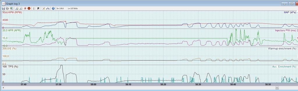

I got a log of such a O2 failure.
Seems like the heater turns off and i got no values until its heated up again, is it okay, that the heating period take around 40 secounds ? Seems to much!

Had a wiring issue (broken contact), so that was the problem why i sometimes got no values. Lambda Heating still takes around 40-60 seconds but i think i can`t change that. I enabled Lambda when no RPM unter O2 Sensor options, so it takes in most cases not such a long time until i got afr values.
