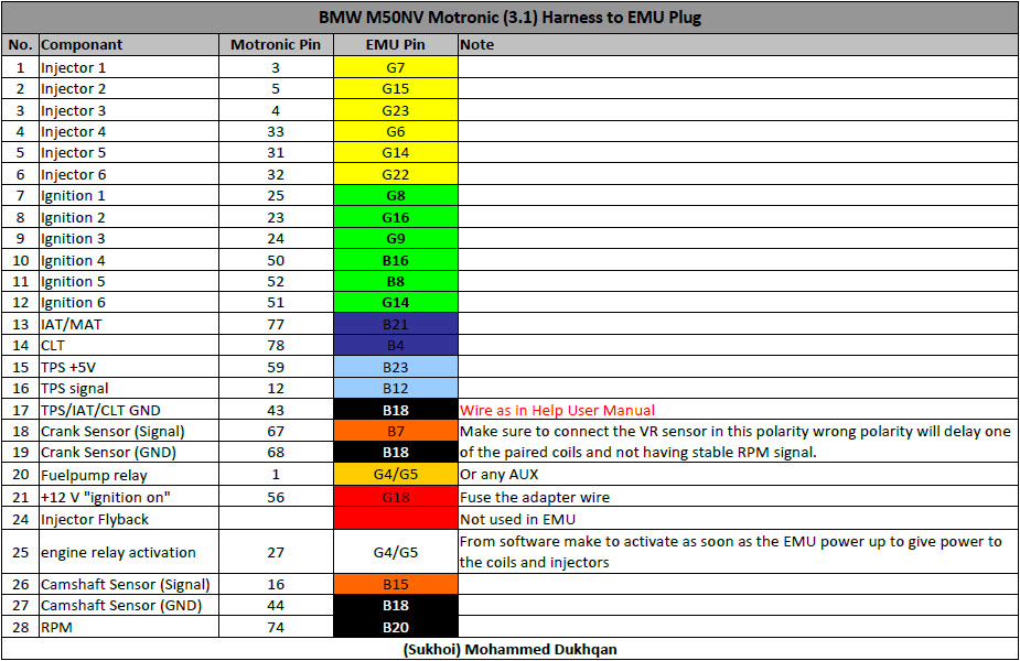

Hi, Here am attaching a file for matching between EMU and OEM motronic 3.1 harness, that can be found on BMW m50 non-vanos engines, hope it can help someone here, but please make sure to test and verify before attaching the EMU unit, as it's your own responsibility and risk, not mine :D
Motronic Adapter Pins Match.pdf
