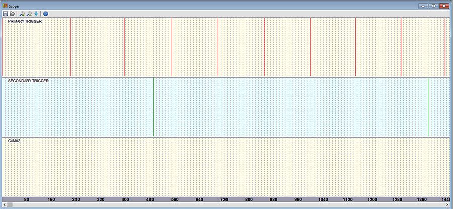

The secondary trigger is quite near the primary trigger. Using a timing gun I can see the timing marks with this setting and have been able to set my base timing to the correct 7° BTDC by changing the 'Trigger Angle' number.
Now, when I change the primary trigger to 'Rising' the scope looks better as the secondary trigger is further away from the primary ...
The only problem like this is that the timing is way out. I cannot see any timing mark even when I adjust the 'Trigger Angle' number.
In the EMU manual it says "edges should be selected in a manner that gives the maximum distance between Primary Trigger and Secondary Trigger edges. If the distance is too small, the synchronizing trigger tooth can change at higher RPM."
These are my primary and secondary trigger settings ...
Any ideas what I should about about this?
