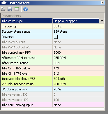

Post up your wiring diagram and a screenshot of your idle configuration menu, otherwise we're just guessing.

Post by JZX100EMU » Wed Jul 27, 2016 12:20 pm
Wiring (Pinout) with the IDLE stuff high lighted
and setting screen shot attached

WHPZach
Posts:184
Re: 1jzgte vvdi idle problem
Post by WHPZach » Wed Jul 27, 2016 6:12 pm
Have you tried reversing the direction? Have you pulled the IACV off the manifold to verify that it doesn't move at key on? Can you share what diagnostics you've performed?
