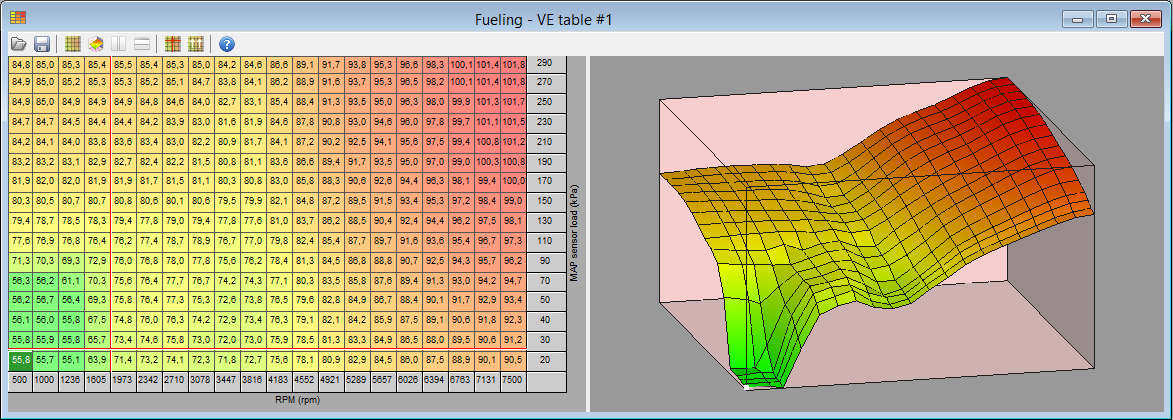

I've got two major problems with stetting correct lamba/ve.
1) I allways get lean readings from lambda sensor at fully closed throttle, but I allready disabled overrun fuelcut and decel enleanment. Is it just a sensor reading error and why does it do that? Also autotuner allways try to set VE to brutal high values. I just put values in, which seemed more realistic to me.
2) I allways get a very low ve in mid range RPM. My VE table just doesn't look right. And also, when I tune VE to correct lambda and change lamda target table after that, lambda readings are not as they should be. Another issue i found, when IAT values rise, my lambda values go lean.
I allready thought, that my Injectors are probaply not set right? I've got 750cc five-o-motorsport injectors (flowtestet by five-o-motorsport, actually 755cc) and injector dead times are also set right. I allready checkt fuel pressure, it's correct.
Engine is a SR20DET, bored to 87mm, 9:1 CR, BC Stage 3 Cams 272°/272° without VTC, stock s15 ball bearing turbo, bosch 2x2 wasted spark, NGK 2668 (BKR8EIX) regapped to 0,4mm.
Somebody got an idea?

I dont have any leak, and my car wants same VE, its same engine, so maybe this engine wants that VE shape to run in the desired afr ...
Re: Tuning issues SR20DET
If you could post a log file, it would have been easier to help.
Injector linearity will affect the VE numbers needed. I wouldn't pay any attention to the lower ve numbers needed at the midrange.

just to give you a quick update:
I've got a complete new exhaust (which doesn't leak) and lambda readings are still bad at overrun, but hey, dont give a fuck, i think the fuel is just not burning right at overrun. My timing isn't late at overrun (something between 35 and 40 degree btdc). I really don't care, engine is running good, but just for my interest in engine physics, does anybody know, what's causing that phenomenon?
I also got my problem with the weird looking VE table under control, I just manualy flatend out the table and voila, engine is running at desired lambda. I think autotuner just pics too much transient data and has a problem with this rpm/map area.
