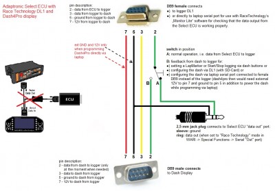

Emumaster connection with race technology dash 2 through DL1
Post by Walezy » Tue Dec 23, 2014 1:05 am
Connect it as on the attached drawing(not made by me) and it will work as i have tested it.

Re: Emumaster connection with race technology dash 2 through
Post by Walezy » Tue Dec 23, 2014 8:51 am
Sure but not this information, it just says how to connect Emu to Dash2 which is not enough if you have datalogger DL1.
