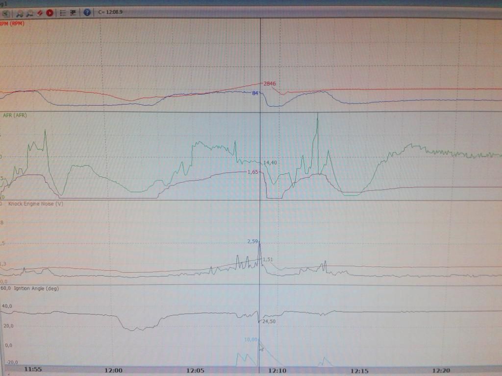

Post by PBU » Fri Jan 02, 2015 9:32 pm
So is this knock or engine noise ?
(2.59V is knock output.)
I think 2800 rpm, 24.5°ign and 84 map is not really knock condition.
I have just installed the new soft so i think i have to adjust something , not ?
You see (bad) on the bottom the ignition retard taking 10° action. So before spike advance was 34°.
Re: Detonation
Post by Jadzwin » Fri Jan 02, 2015 11:30 pm
Engine Noise 2D table is used to calibrate noise level of normal engine operation on whole RPM range. If Knock sensor value exceeds Engine noise from table, it is interpreted as engine knocking. This difference is named Knock Level. Higher Knock Level means more severe engine knock.
So first you need to build your engine noise table based on non knocking engine based on knock sensor value. Then if the knock occurs the knock level will be > 0.
In next week we plan to release the 1.1 official version. There will be help in English for every EMU option so all information about knock sensing will be available.
