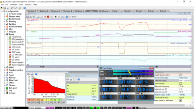

i have my boost target set to 250kpa across the table but in my log it says it is set to 375 kpa so when i use my boost controller it doesn't open the waste gate had a nasty 280 kpa spike! please need help.

You have boost correction 150% ( 250 kPa *1,5 = 375 kPa )aaronRX72JZ wrote:i have my boost target set to 250kpa across the table but in my log it says it is set to 375 kpa
Check GEAR SCALE, VSS SCALE, IAT SCALE, EGT SCALE.

i found it. it was the EGT table. thank you for the help.
