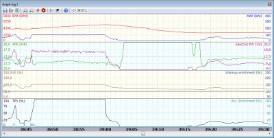

i just want to know if you guys would recommend to enable the MAP filter function ? Look at the graph below, in full throttle position the MAP curve is somehow spikey and also Injectors PW. I don´t know if filtering is necessary or not.

You could try to use light filtering. Mode 1 has the highest cutoff frequency. You can increase to filter power in MAP Filter power table (it works for mode 1-3 only)
If you set too much filter power your throttle response could be laggy
