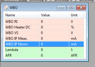

i have a problem since 2-3 Months with my second EMU,
AFR/Lambda shows only 1
ive checked 100 times the wiring, changed the Laptop, changed the LSU :(
Can u help me maybe? it has never been shown something else than 1 :(
my other EMU works perfect :)

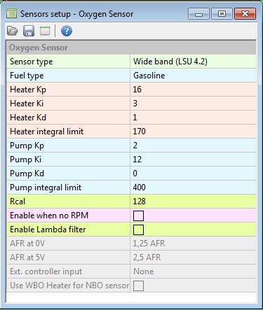

here u can see my settings / ive tried things like enable when no rpm

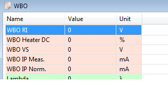

One last hope:
1. Are the Outputs/Inputs for the LSU 4.2 one the ECU fix ? Or can i change them?
2. on my Log all values are moving except of the AFR/Lambda, my this help :)

Ok than i will send it back in 1-2 Months,
but mybe can u give ma tipp how i can read mybe in a other way the Lambda ?
Which of this values will show me the Lambda in Volt ?? Or will my plan not work :D
