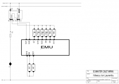

My pinout details:
B1 - Not Connected
B2 - Knock Sensor
B4 - CLT IN (Coolant temperature sensor)
B5 - WBO Vs (PIN 1)
B7 - Primary Triger ( RPM Sensor)
B12 - TPS In (PIN 3)
B13 - WBO Ip (PIN 6)
B14 - VSS IN (Speed Sensor from gearbox)
B15 - Cam Hall Sensor (PIN 2)
B17 - GND ECU
B18 - GND for sensors
B21 - IAT IN (Intake Temperatur sensor, PIN 1)
B22 - WBO Vsip (PIN 5)
B23 - +5V feed for TPS and HALL Sensor
B24 - GND Power
G4 - (AUX 6) Tacho from instrument panel
G5 - (AUX 3) BOOST Wastegate Control Solenoid
G6 - Injector 4
G7 - Injector 1
G8 - Ignition Amplifier signal
G11 - Engine Fault Lamp
G12 - (AUX 5) Coolant FAN
G13 - (AUX 2) IDLE Control Valve
G15 - Injector 2
G17 - GND Power
G18 - POWER +12V from Switch Live (Ignition ON Live feed)
G19 - WBO Heater (PIN 4)
G20 - (AUX 4) Main Relay (PIN 1)
G21 - (AUX 1) Fuel Pump Relay (PIN 9)
G23 - Injector 3
G24 - GND Power
Extra Info:
Ignition Amplifier
1. Unused || 2. GND || 3. +12v || 4. Signal (G8 emu pin)
Throttle Position Sensor (TPS)
1. Power +5v (B23 emu pin) || 2. Signal (B12 emu pin) 0.1 - 0.7v closed and 3.5 - 4.7v open || 3. Sensor GND (B18 emu pin)
Cam Hall Sensor
1. GND (B18 emu pin) || 2. Signal (B15 emu pin) 0-5v (fluctuation) || 3. Power +5v (B23 emu pin)
Wastegate Boost control solenoid
1. Command (G5 emu pin) || 2. +12v from main relay maybe
Mini Loom
