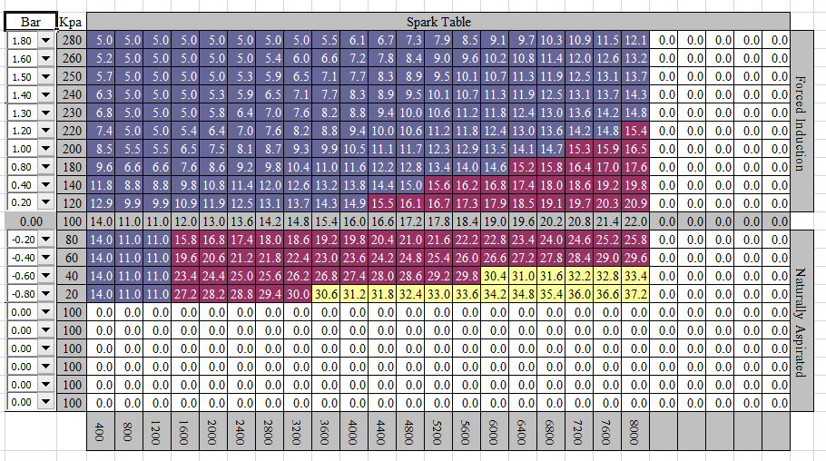

Like the title says i need basemap for coil with distributor version so i can start my car, does anyone have?

this might help a little
this will give you a start

Re: c20let with distributor. basemap needed
Post by Jadzwin » Fri Jan 09, 2015 5:53 pm
Try the following config (and check your trigger edge, here more info http://www.ecumaster.com/Help/EN/igniti ... rEdge.html)
