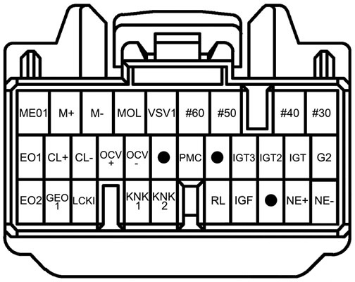

VVTI is not connected.
From 2JZTGTE VVTI pinout:
OCV-
VVTi Solenoid
Output
This pin control the solenoid that controls position of intake camshaft
OCV+
VVTi Solenoid
Output
Where OCV- and OCV+ should be wired?
What numbers should be in parameters?
2JZTGTE VVTI wire and setting

Re: 2JZTGTE VVTI wire and setting
Easy as it can be.
One +12V
Second to EMU AUX
Nothing special.
One +12V
Second to EMU AUX
Nothing special.

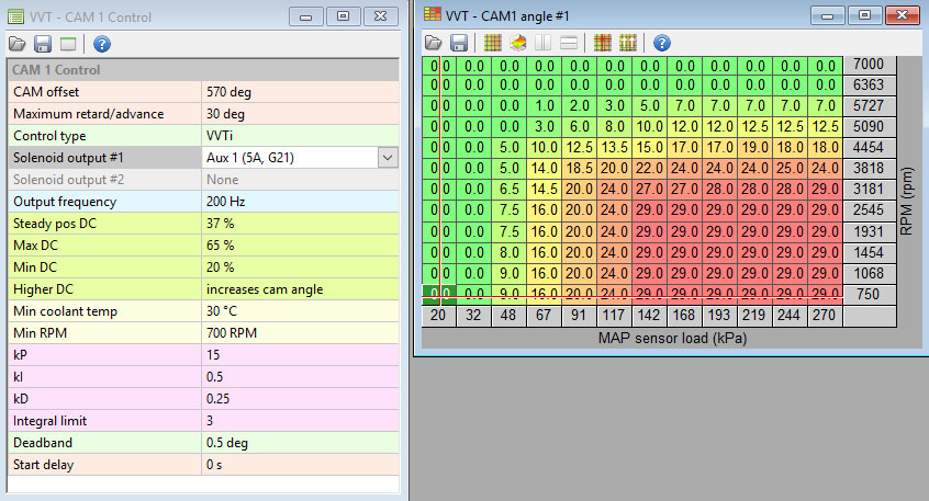

Got it.
How about parameters (CAM control and angle)?
Just leave them as default?
