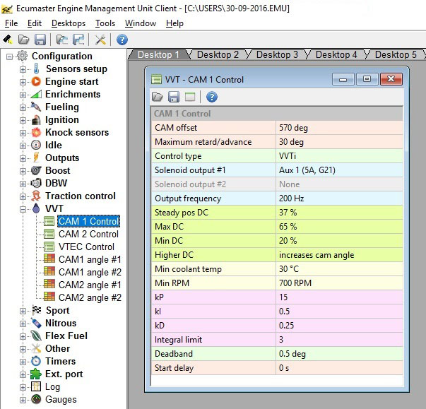

We install VVTI as told in this forum.
Engine cant REV above 4000 RPM.
Then we uninstall VVTI and load back MAP previous to VVTI.
It is the same, engine only can REV around 4000 RPM.
What can be wrong?
Enclose MAP and LOG files.

try to set sensitivity swich in CAM input to 2000

I scroll down from "sensor setup" to "gauges".
Cant find "CAM input".
There is no "CAM input" in VVT ---> CAM 1 Control.
Where is it?

Ignition - Secondary trigger

Try all possible options.
Still unable to REV beyond 4000 RPM.
Just turn off this feature and work fine.
