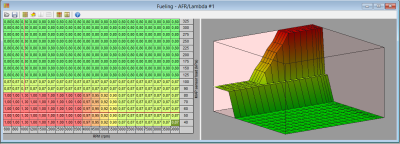

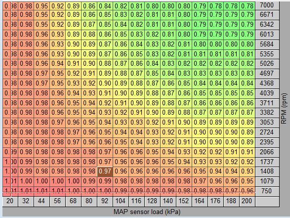

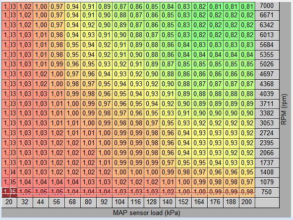

As the first step in advanced fueling strategy and the new autotune option is setting up a Lambda/AFR target table, I thought it would be a good idea to share our tables together with info about the engine/mods so we can learn from each other and setup a base table which gives you a relative safe starting point.
Some info about AFR numbers with thanks to Clem:
For my first attempt I kept the numbers relative low to be on the safe side as no tuning has been done yet.clem wrote: AFR Target table should be tuned accordingly to VE and EGT. Higher VE means higher cylinder pressure and therefore higher combustion chamber Temperature. Higher gas temperatures in the compression stroke give a higher tendency to abnormal combustion (Knock in best case, Pre Ignition in worst case). To give you an idea:

Only add fuel (lambda < 1) if there is danger of abnormal combustion or your EGT is too high for your turbo or your catalytic converter.
At lambda ~ 0,9 you could get the most power out of your charge. At lambda ~1,1 you could get the most power per fuel out of your charge.
With these very generic rules you should be able to create your own Target AFR table. VE, IGN, AFR, BOOST, have to be tuned to work together for one specific engine setup.
Compare Maps from different engines with different mods could mislead you if you do not 100% know what you are doing. Try to give your setup what it needs and have fun with that vastly big puzzle![]()

My engine:
VW 1.8L 8V
T28 turbo
550CC injectors
270 degree cam
Group fire injection, distributor for spark.
