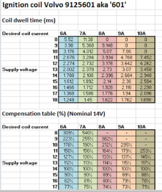

I'm using 9125601 volvo cois and the dwell times are the lowest(6A) from the table I'm attaching.I found that table online, can anyone confirm those settings?
Does these coils need a suppressor on their power supply

Re: Unexpected missing tooth cause ?
The numbers look resonable.
Please post the log here we will be able to help you for sure.
