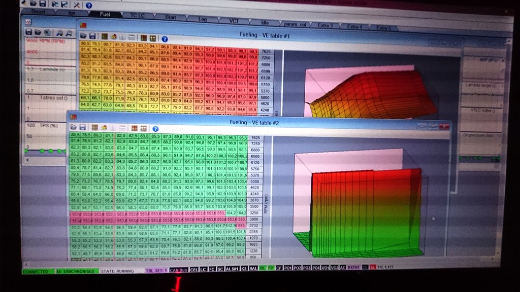

I remember, a while ago I drove my car, turned engine off and ignition on again to tune the emu. I made some changes, maps permanent and turned off the ignition and left the car - nothing strange here. After one hour i started the engine, but it would not rev over 3000. Immediately plugged in the laptop and saw that in my VE table there were some values as high as 6500 (i was only using table 2 back then). I took a picture with my phone: Even if some cells were marked and something hit the "+" button for a while, that could not happen, as the max value you can enter is 400.
I re-uploaded my last safed version - everything fine again. ............COULD there have happened something to my emu/usb connection?
