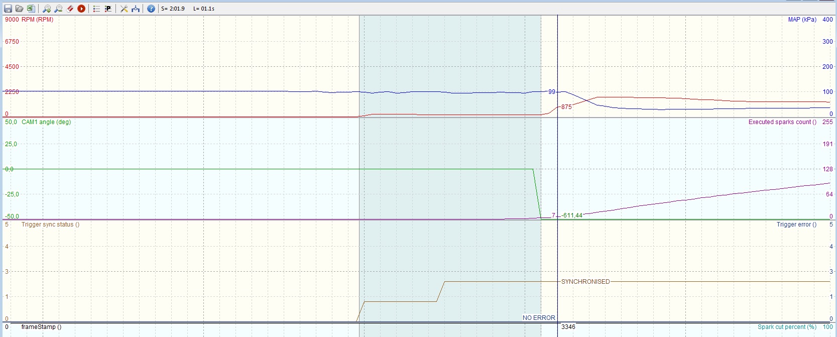

here you can see what i mean,
this is 1.8t 20v
60-2 on crank and 1tooth on cam
cranking time is more than 1sec doesnt seems lot but it realy does not sound like you would like to hear
this is 1.8t 20v

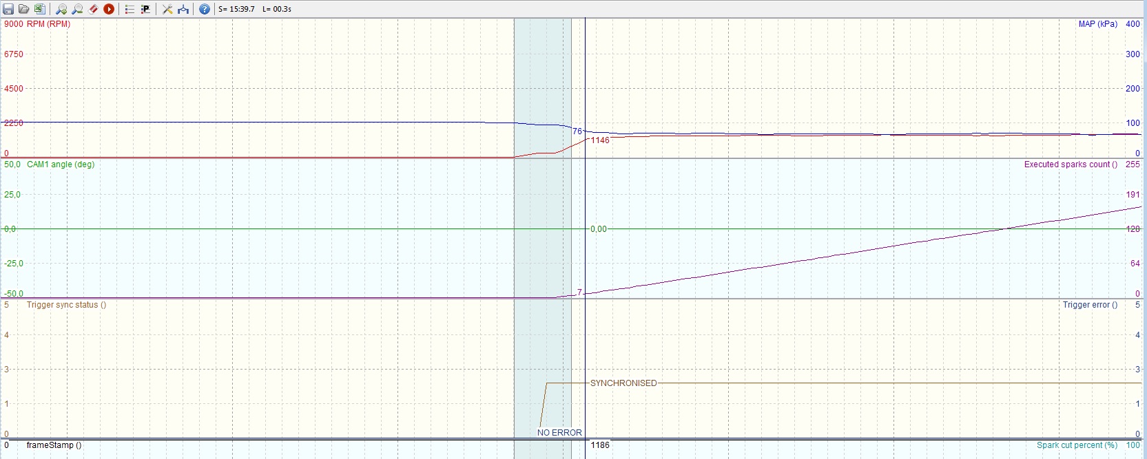

here is how it should look...
vw 1.4 16v engine
60-2 on crank
no cam sync
wasted spark
vw 1.4 16v engine
60-2 on crank
no cam sync
wasted spark
Re: best trigger disc pattern
If you dont sync on CAM, you dont need to wait for full 2 revolutions of the engine to get synced...... simple........ but you will end with no posibility of full sequential injection, or variable cam control.
I have seen few Honda S2000 with damaged starter on AEM EMS when selected "start without cam sync" ........... i dont see something bad on wait 1-2sec before start
