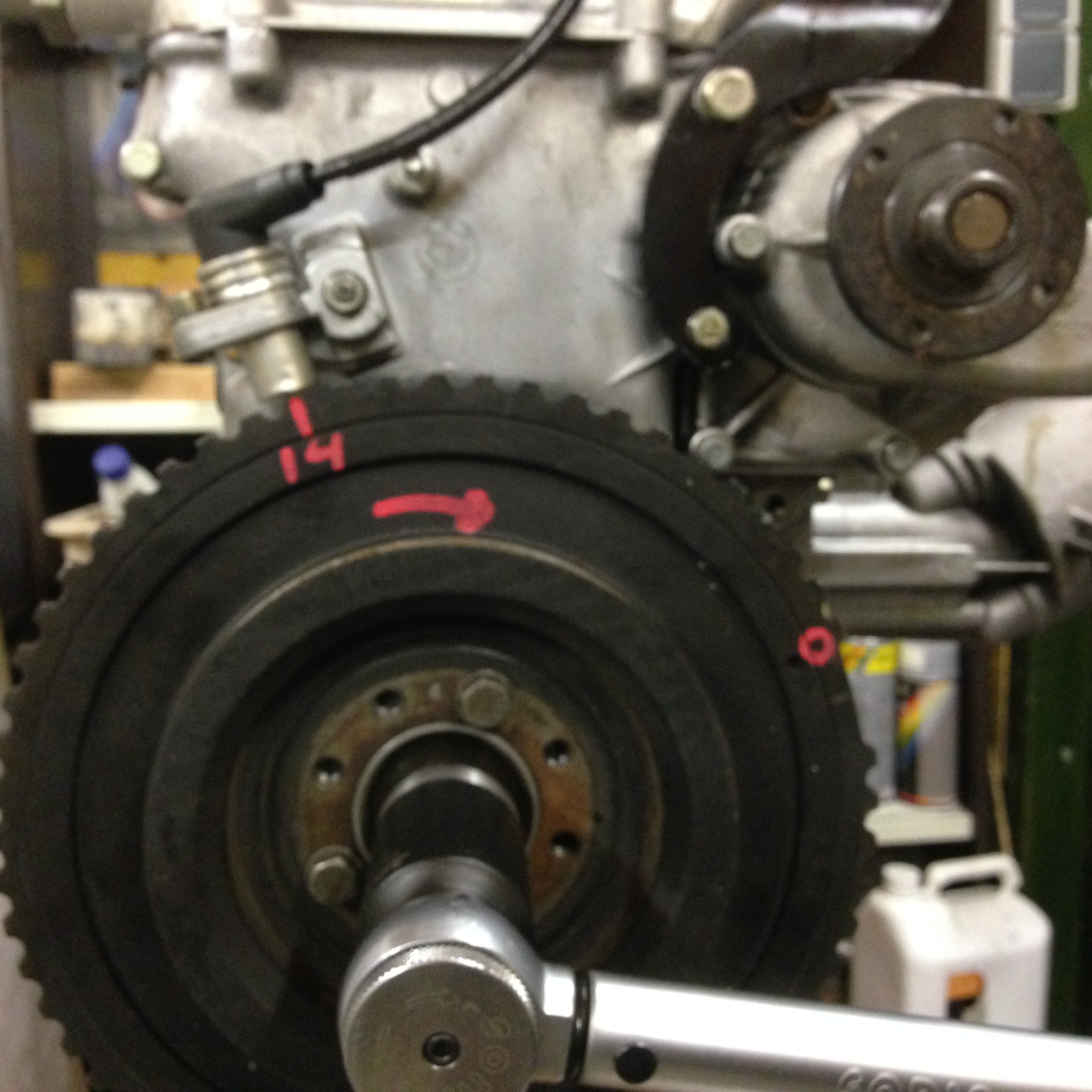

I've taken a look at my triggerwheel setup last night it's a S38B36 but I think yours wil be similar. I believe the settings from PSI motors are correct.
My sensor is located at tooth 14 with cylinder 1 at TDC.
Regards,
Angelo
Picture of triggerwheel S38B36

This is how I believe you determine the settings, (all theoreticly as I haven't got an EMU yet):
1 Place cylinder 1 on TDC
2 Count the number of teeth which have passed the vr-sensor up till that point. Counting from the two missing teeth, the first tooth is numbered 0.
In my example photo above tooth 14 is at the sensor when cylinder 1 is at TDC. So 15 teeth total since we're including 0
3 Take a amount of ignition advance you'll never reach, for example 54 degrees triggger angle.(always a multiple of 6 since 360/60=6 degrees per teeth for the 60-2 trigger) This equals to 9 teeth since 54/(360/60)=9 dertermine trigger tooth 14-9=5
4 Check if each following ignition event doesn't coincide with the 2 missing teeth. Ignition event spacing on a 6 cylinder 720/6=120 degrees or 120/6=20 teeth trigger tooth for next event is 5+20=25
25+20=45 45+20=65 etc.
If it does coincide, you have to choose another setting.
I hope I'm correct and that it's helpfull.
Regards,
Angelo
