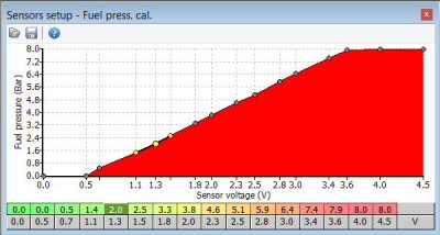

been messing around with the settings tonight for when my sensor turns up im useing a 150 psi fuel sensor but as it only goes to 8 bar on the scale would you say below pic is ok or should i add more numbers around the 3-6 bar part of the scale and not worrie so much on the really low end and high end of the scale
i will be running around 5-6 bar fuel pressure when running anyways
many thanks

I would change the voltage line from 0.5 to 4,5 and it is not needed to have more values around 3-6bar because the sensor signal is linear. I have the same settings and it work fine.
Only issue on EMU is, if you change x-axis the other sensor setup tables change too.

hi jan
yes i noticed that when i was messing around with the tables
thanks
