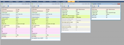

I have problems with settings for variable valve timing.
Engine: M54B30 Double Vanos
For intake cam EMU doesn`t see camshaft position angle and for exhaust side there is problems with movement direction.
Will try to explain.
So there is my triggers setup:
Here is Scope:
Its base VVTi-settings(for seeing angle correction needs):
Then im adding angle corrections:
Then im setting AUX outputs, and you can see that there is Angle targets
but CAM1/CAM2 angles doesn`t move. When im changing CAM1 solenoid minimum DC
in fact cam is moving(engine goes faster) but CAM1/CAM2 angle in logs doesn`t move.
But if i will change CAM2 cam movement direction to "increases cam angle" in logs i see that
camshaft positions go to negative:
I tried "1 Tooth", "Missing tooth", "2 Symmetrical tooths" patterns for "Secondary trigger" but it does not help.
I tried to move camshafts trought PWM#1 - and they booth are moving in fact(engine goes faster/slower),
but in log i cannot see camshaft angles.
In scope you can see data from both camshaft position sensors - so they works.
So can somebody to tell me whats wrong ?

Post by RHD » Sun Jul 16, 2017 4:32 pm
this...

Post by web » Sun Jul 16, 2017 6:44 pm
Doesn`t help. When i set your settings RPM groves up until 3600 with same Idle DC(intake camshaft started moving) but camshaft angles in log was zero.

Post by Karel » Mon Jul 17, 2017 3:51 pm
Move the cams to max retarded position and fix the Cam pffset angle. Then the EMu should see correct value.

Post by web » Tue Jul 18, 2017 6:32 pm
Looks like exhaust cam moving now - there are some strange movings but its moving to right direction in right time so its ok.
Intake cam still have the same angle all the time.
I turned off intake side control(VVTI) and when im changing intake camshaft position using pwm#1 - engine moves faster but angle isn`t changed - how its possible ?

Post by web » Sun Jul 23, 2017 12:54 pm
I found problem. I mixed up vanos solenoid wire with one wire of the idle valve.
So when i tried to control solenoid trought PWM#1 engine starts to move faster - and it was because of idle control valve and not because of camshaft movings :D :D :D :D
