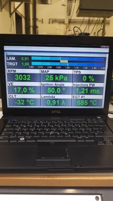

But we have the problem, that a few moments after start the engine tries to run with 3000 rpm. It is not possible to reduce the rpm with throttle (DBW-modul). The throttle plate is in idle position.
Maybe someone has an idea
Here is a photo of our tune display. By the way the CLT senor is defective
