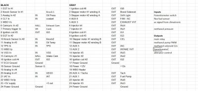

Attached what I came up with. I still need an input for AC. Is MUX input reliable?

hmmm.........
the FlexFuel Sensor should be connected to CAMsync #2 and this is what you need to control your secondary cam... os also conflict....
You can use one single analog input to provide 3 information using MUX resistor divider. But this informations must be just switches ON/OFF and the can have any king of additional voltage on them.
you have just 4 independent analog inputs
6AUX outputs (normal current)
4stepper outputs (low current)
i would generally think more about EMU BLACK in your case
it has dedicated FF sensor input
it has 6 analog inputs
it has 3 additional switch inputs
it can handle LSU 4.2 but also LSU 4.9
it has high current steppers

What exactly do you mean by this? Fry circuits or cause a stutter?
Flex sensor is optional. Just want it in case an e85 station opens up near me.
Black is better suited and in the grand scheme, isn't really that much more. It's still 300 though.
With the mux and vss boost switch, i got almost all i want. Just worried with the stepper circuit.
How come boost isnt included in table switching?
Re: Are there enough input / outputs
You can use same switch for switching maps and also the boost, just in other table
Ahh yes. Just use select same input for the switch
