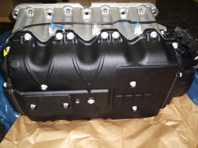

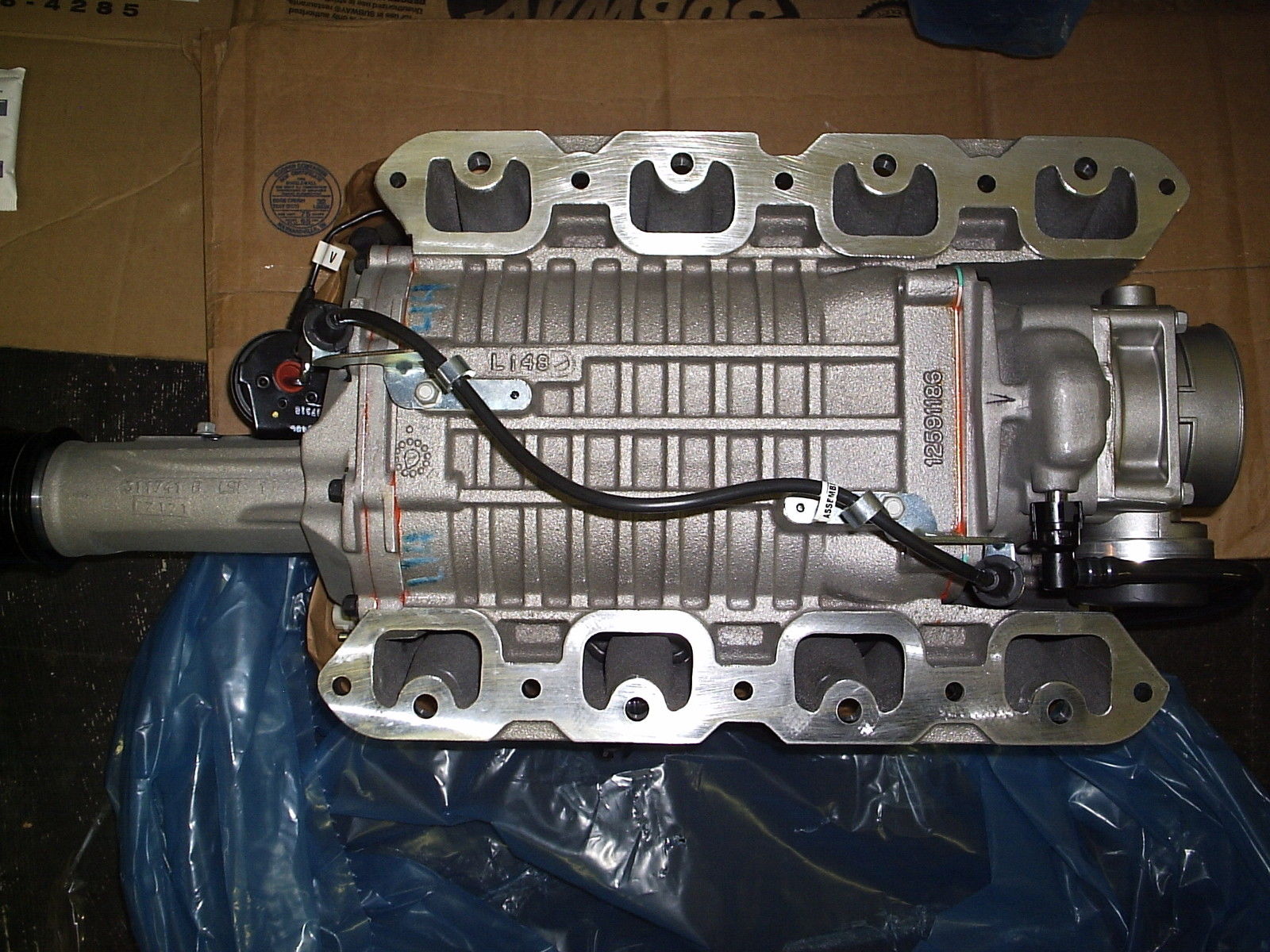

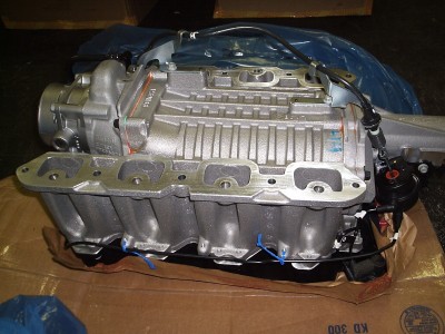

i have a drift car too!!
i use supercharer roots type with intake manifold and internal water cooler on the top of cylinders head.
cadillac supercharger from sts-v 4.4
my target is work with stock internals on 0,8 bar max.
