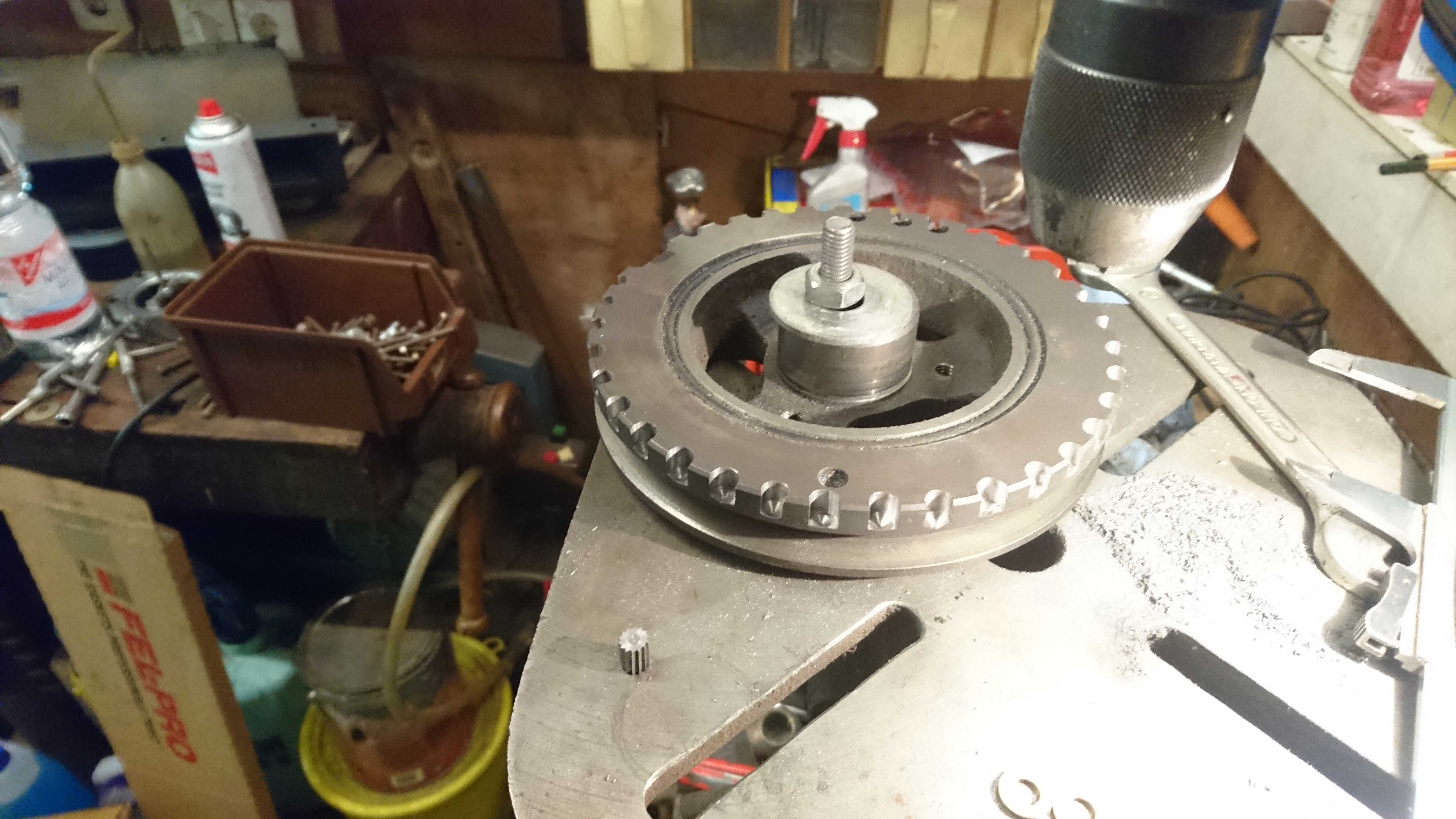

going the simple way....
36-1 drilled in Damper - <pic>
and its flying :-)

But with 40 degree late ignition. covering this due to upping ignition map and ignition event trims in summary 40 degree car runs very smoother than with the self made 36-1 trigger on the damper.
specially car start at first gear becomes much better. Seems to be much more torque at idle....
..more teeth, less flexibility of the damper.

summed up - I am lucky with the old renix 66-2-2-2 trigger. it's more exact than my selfmade 36-1 trigger on the damper with the rubber ring.
