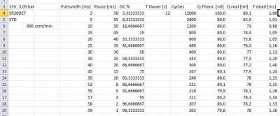

I tried to do measurings, to determinate the deadtime of my original SR20DET Sidefeed Injectors but discovered problems.
The deadtime of the seems to be influenced by the pulsewidth itself, which theoretically should not be possible (in certain Duty Cycle regions).
Did your measurements put out similar dependencies? Please see my attached picture.
The only explaination I have for this sympthom is, that the fuel Pressure is too much inconsistent over the whole range. I use a normal RB25DET Fuelrail with OEM Fuel pressure Regulator and approx. 0,5m Fuel line with a Fuel Filter inline. Did you use some certain Fuel pressure Dampeners or similar to achieve a real CONSTANT Fuel Pressure?

Clem i am not Patric, but i think that everything over 20ms is little too long
what we have:
6000RPM and 1injection per 2 revs
so 3000/60 = 50injections per second => 20ms per each injection at 100% DUTY (your 60ms means, that you want 100% DUTY at 1500RPM, and i think this will never happen)
Now what i think is, that if your pulse width starts to be too long, the coil in injector start to warm up, and the resistence of the coil start to climp up also..... result, less current and less magnetic field to move needle inside the injector and larger dead time.
Also diference 0,3ms of death time at 60ms pulse is very low, and will not make huge AFR change.

I can't see the picture from here but Karel has right.
A realistic max PW is 20-24 msec.

Well Pbu , you may have to log in to see it ?
AAAh Ok I did not think very much about the cycle time as it should be not significant to the results. But it makes sence as you explain it!
