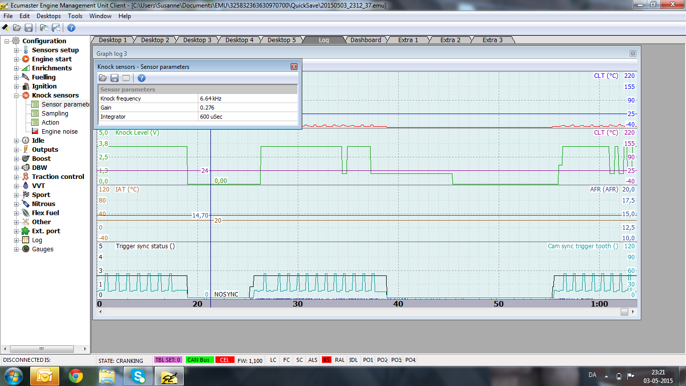

After upgrade of firmwire, my 2jz will not start... It was starting perfect before upgrade..
First i downloaded the new version of software from the website, and then i upgraded the firmwire on the ecu..
Can you check if there is anything in my map i have done wrong?
I got this message after upgrade:
"Loading project warning log.
Error: Cannot find table boostDCTable in current project. Skipped.
Error: Cannot find table etcOpenOverRevs in current project. Skipped."
Can it have some influence ??

For what firmware version did you upgrade ? And from what version ?

Jadzwin wrote:For what firmware version did you upgrade ? And from what version ?
1,016 before to 1,100 now
My software is 1,100 on my pc.. Cant remember last version...

Can it maybe have something to do with Knock Sensor?

Re: Problems after firmwire upgrade
Post by Jadzwin » Mon May 04, 2015 12:59 am
Hi!
For 2JZ VVTi we changed the CAM decoder to improve engine start.
Here is a document how to setup trigger and VVTI
https://dl.dropboxusercontent.com/u/286 ... e_vvti.pdf
If you have any issues please let me know.
