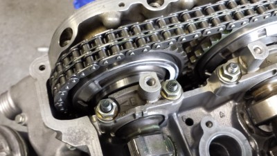

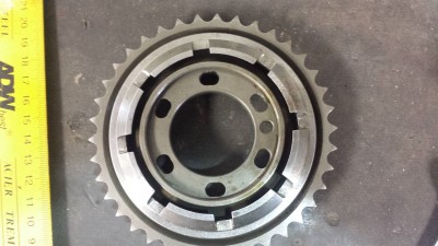

i have s50b32 turbo non vanos ,i used for intake tothwhel of s50b30(exhaust) and jadzvin advised me
remove three teeth,and use misingtoth
Tried here as the Hall sensor,as well as VR, But I still have the same problem

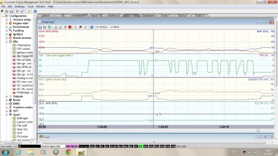

Please attach the log and project file
Re: s50b32 cam sync problem
Jadzwin wrote:Please attach the log and project file
- 20150505_1655_35.emu
- (85.27KiB)Downloaded 92 times
- scope_201555_181problem s hall senz.emuscp
- (401Bytes)Downloaded 70 times
- 20150505_1504cukani pri plynu.emulog
- (1.67MiB)Downloaded 71 times

Looks like signal noise from cam sensor.
You can try 2 missing tooth decoder.
Hoever I think the only solution is to disable cam sensor over 600-700 RPM

tried HALL sensors connected here, and VRJadzwin wrote:Looks like signal noise from cam sensor.
but interference with VR was smaller
trigger type I tried them all, but either did not start or still the same problem
Tomorrow I'll try to disable cam senzor
thanks

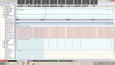

Actually to fully diagnose the problem you need to use scope and check the signal shape, noise and so one.
Jadzwin wrote:Actually to fully diagnose the problem you need to use scope and check the signal shape, noise and so one.
do not oscyloskop available
I have to ask a friend to help me
The fastest solution for me is to try to disable the cam sensor,for now
