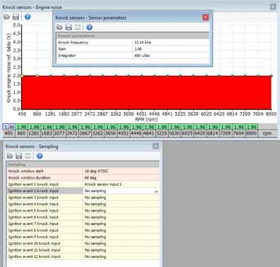

C20LET proper stock Knock Sensor configuration
i only get engine noise but can't get knock configuration right.
Re: C20LET proper stock Knock Sensor configuration
the let knock sensors are around 8 khz if thats any help
OEM ECU uses 13.1kHz as knock resonant frequency.
