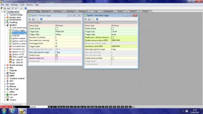

triggers

Post by Jadzwin » Tue Jun 16, 2015 12:33 am
You have several option.
1) Try to set sensitivity switch to eg. 2000 RPM. Above this RPM the arming threshold for CAM input will be high what increase nois immunity of this input
2) You can also disable CAM sync above certain RPM but it is not advised in case of multitooth primary trigger
3) You can connect 20K resisotor in series with CAM sensor input

Would it be better to change to a 36-1 crank trigger and not use the cam one?
Re: 1uzfe intermittant sync error
Post by Jadzwin » Tue Jun 16, 2015 1:24 am
36-1 is better than 12 Mt + cam sync, however there are many 1uzfe with oem trigger that perform very well, so personally I wouldn't do it.
