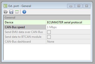

My android phone connect perfectly but dont read any parameters. All show 0.

and did you configured your emu output ?

Ups :o each day learn new things

Post by roquete » Sat Aug 22, 2015 11:10 pm
Yes you do, first pair your phone/tablet with bt to "emubt" device, use code 1234.
Then open the app and choose "emubt", dont forget to choose ecumaster serial protocol in EMU.
