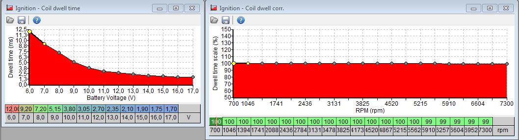

i build My engine C20XE (turbo) with this VAG coils
BOSCH 0 221 604 115
This is what I found regarding the pins
this wiring is ok?
and what is right configuration (in software) ? for my engine?
and what about fuel tank vent valve? is possible?
