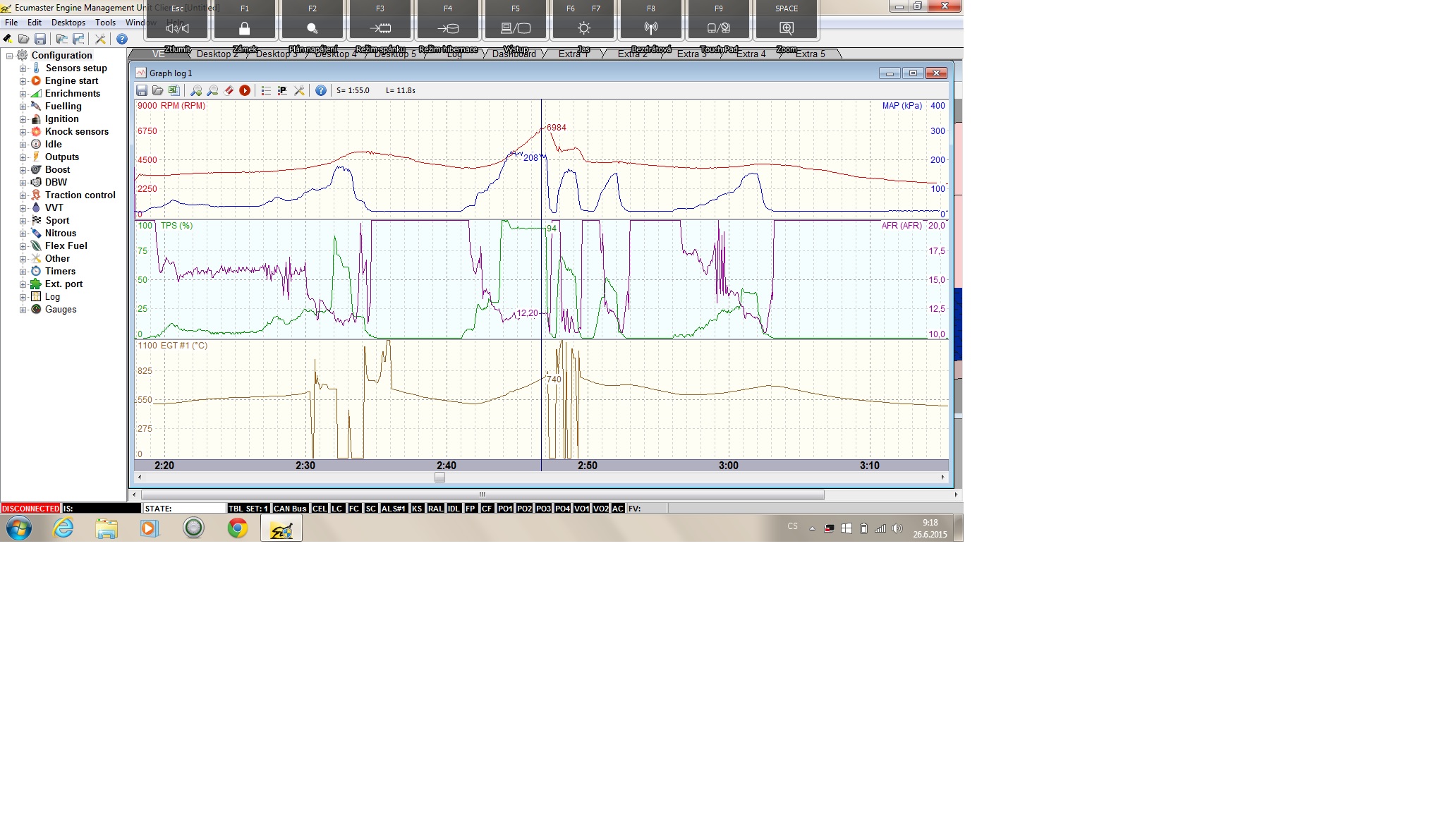

EGT fluctuations
some hints what it could be
It started a few days ago, had never done before
regards
M

Re: EGT fluctation
Post by Karel » Fri Jun 26, 2015 12:02 pm
Connection problem or some noise coming in ?
Re: EGT fluctation
Post by Jadzwin » Fri Jun 26, 2015 5:17 pm
Looks like connection / grounding problem. Or your sensor connect to the sensor shield

Re: EGT fluctation
Post by mmt » Fri Jun 26, 2015 8:40 pm
I checked the sensor
for sure
 I switched from I egt1 on egt 2
but according to the log, after crossing about 600C
, fluctuates independently of the load
it is possible that the sensor is faulty
thx
M

Re: EGT fluctation--resolved
Post by mmt » Fri Jul 10, 2015 11:34 pm
resolved
sensor was faulty, here today, to try a new one I bought(efischop.pl)
no more fluctation :D
