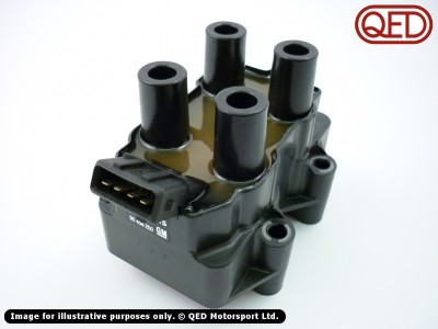

the coil pack new ???
we use the ecotec coil pack and that does the same thing when its getting old and we run 3 bar of boost on one of these coil packs up to 8200
but the sensors are known for it after 6.5k hall sensors are better over vr ones but if its a new sensor and its wired correct then it should be a problem we have had a vr to 9.5k with out problems a few years ago on megasquirt

i dont thing this is a vr sensor problem, because i dont lose crank signal, all the rev range.astra vxr wrote:the coil pack new ???
im thinking to install a 032 905 106B vag coil, i use them on others install with success,
this coil have a built in driver.
do you have a picture of this ecotec coil??? or reference???
regards
Re: opel/vauxhal C20Xe configuration
this one is what we used to use
