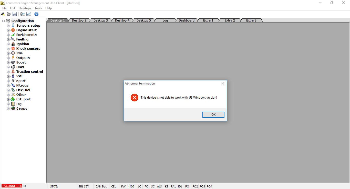

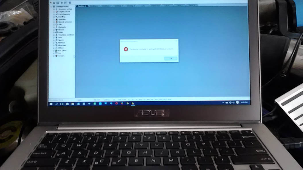

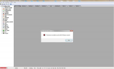

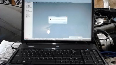

Re: Toyota Aristo JZS161 2JZGTE VVTI
Dear gregpe,
I installed "CDM v2.12.06" on Windows 10 64 bit.
Device detected/found.
But it shows "This device is not able to work with US Windows version!"
Try to install "CDM v2.12.00".
Display "This device is not able to work with US Windows version!"
I switch to old laptop, Windows 7 32 bit Pro.
First I do not install "CDM v2.12.06".
Device (ECUMASTER) undetcted.
Then install "CDM v2.12.06".
Device detected/found but it shows "This device is not able to work with US Windows version!"
Same message appears by installing "CDM v2.12.00".
How to solve this problem?
I enclose screen shot from both laptops.
Cheers

Deni Dermawan
- Posts:25
- Joined:Wed Aug 19, 2015 3:14 pm
You need to update to latest firmware 1.138. Search forum for test versions link. Or maybe someone will post it up here
Change the language of the control panel in you windows. I have had the same problem. English windows but acted emu in Sweden . had to do a language update to Swedish.

Dear Vortex,
Today We change Windows language to Polish, Spanish, German, not working.
We change Windows region, not working.
We update "machineInfo.dat" given by ECUMASTER
Message still appear "This device is not able to work with US Windows version!".
We try a laptop from Singapore market (Windows 7 64 bit).
Not working.
