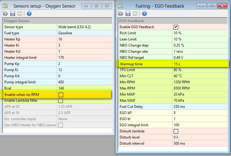

Hi All,
Been fidding with my idle settings on my 2jz with emu after just finishing wiring the harness and have an issue with the wideband sensor. It works fine once the car has been started for about 5 minutes before that it gives no reading at all. Its an AEM Brand 4.2 Wideband. I have heard they need to warmup but didnt think it was this long.

check settings :

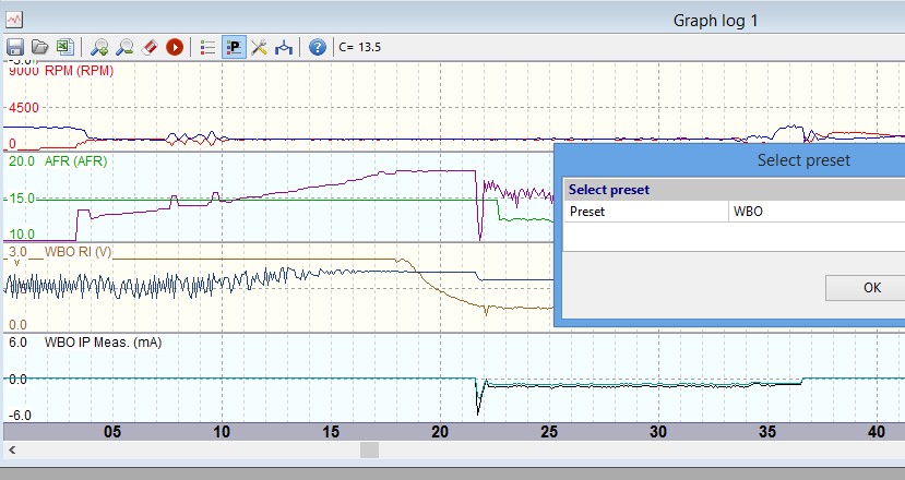

look at log:

I have ego feedback disabled tho its still on 60s warmup time and i just checked the logs and it is working after 60s. Car stalled a few times so it reset the 60s. I didnt have the enable at no rpm on either.
Should be all sorted now.
Thanks heaps :D
