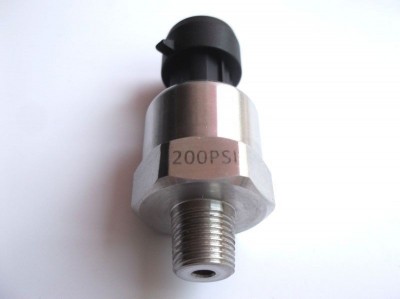

We are using a OEM water temp sensor and this type of pressure sensor:

i use them too wire it up like a TPS if it cane with a plug and wires, +5v red, sensor ground black, analog IP green,
