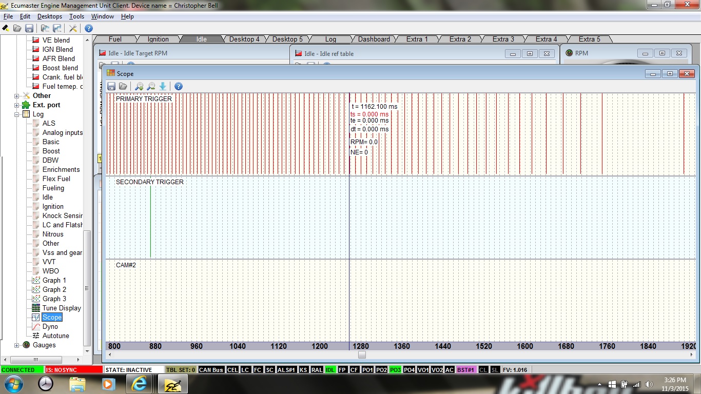

well, I took a scope of my car when the rpm drops down to the 800 range.
no matter what I do in the pid or ign idle table, or the commanded idle rpm, the car will always die.
I even made sure to set my base idle air bleed/throttle stop screw to 950rpm with the iacv capped off. so it "Should" be able to idle even if the iacv is parked with the PID and everything turned off.
it looks like my secondary trigger wave disappears below 800. do I have a bad sensor? too much resistance on that circuit: 20k ohm? idk where to go next. right now, ive just set my idle at 990 with an overshoot of 100rpm dialed in with no AC or PS load. its recovering and catching itself on down rev while just sitting at in the driveway.

Please post a scope on idle at around 1000rpm
Re: stalling below 800rpm no matter what?
That was idle at 1000.
The sync is perfect at 1000 and cranking.
But you see the tail end of the idle rpm where I load the motor with power steering input. Then the rpm drops below 800 and the secondary trigger signal disappears and then the motor died.

there is a sensitivity switch setting on the secondary trigger
