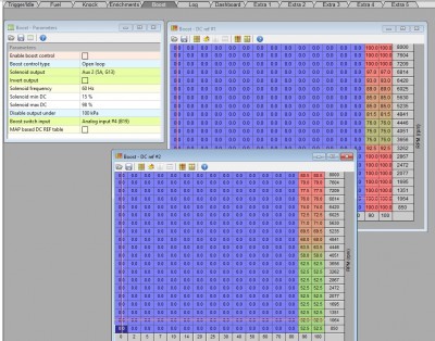

We use the same valve but we plumb it a little differently. I leave port#1 open, port #2 to wastegate, port#3 to Boost source. No tee's etc... If you are using an internal gate it will bypass through the solenoid when boost control is off or no signal to Solenoid. I usually don't see a change in boost until 25-30%DC, and just use open-loop for now, don't worry about target boost. If your on an external gate run the hose from port#2 to the "bottom" of actuator, and leave the top open to atmosphere.
I attached a screen shot of how I have boost set-up on the last Gen4 3sgte I tuned. Table #1 is E85, table #2 is pump gas. I have found no need to tune anything below 90% throttle, as the WG spring still controls boost in part throttle situations. It was out of WG spring on E85, hence the 100% DC at high RPM. Get everything dialed in on open loop, then you can use either simple DC correction to maintain correct target, or full closed loop using PID control.
