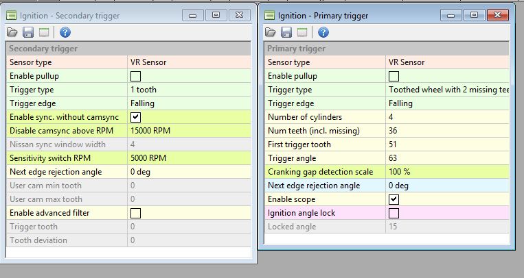

these are what i use for settings
edit , mine is a st215 engine

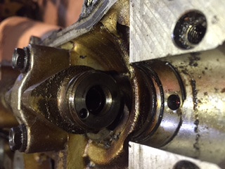

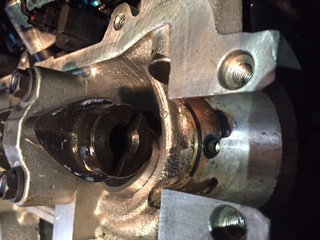

We figured this one out, after Saaed re-installed the EMU he started getting a cam signal, and from the scope we figured out what was happening. Saeed has aftermarket cams, and he installed the cam reference tooth to the end of the cam like the stock cam. He used the distributor slot to reference the trigger tooth, which is a few degrees off from the gen4 cam, and it just happened to line up with the 2 missing teeth on the crank trigger wheel.
