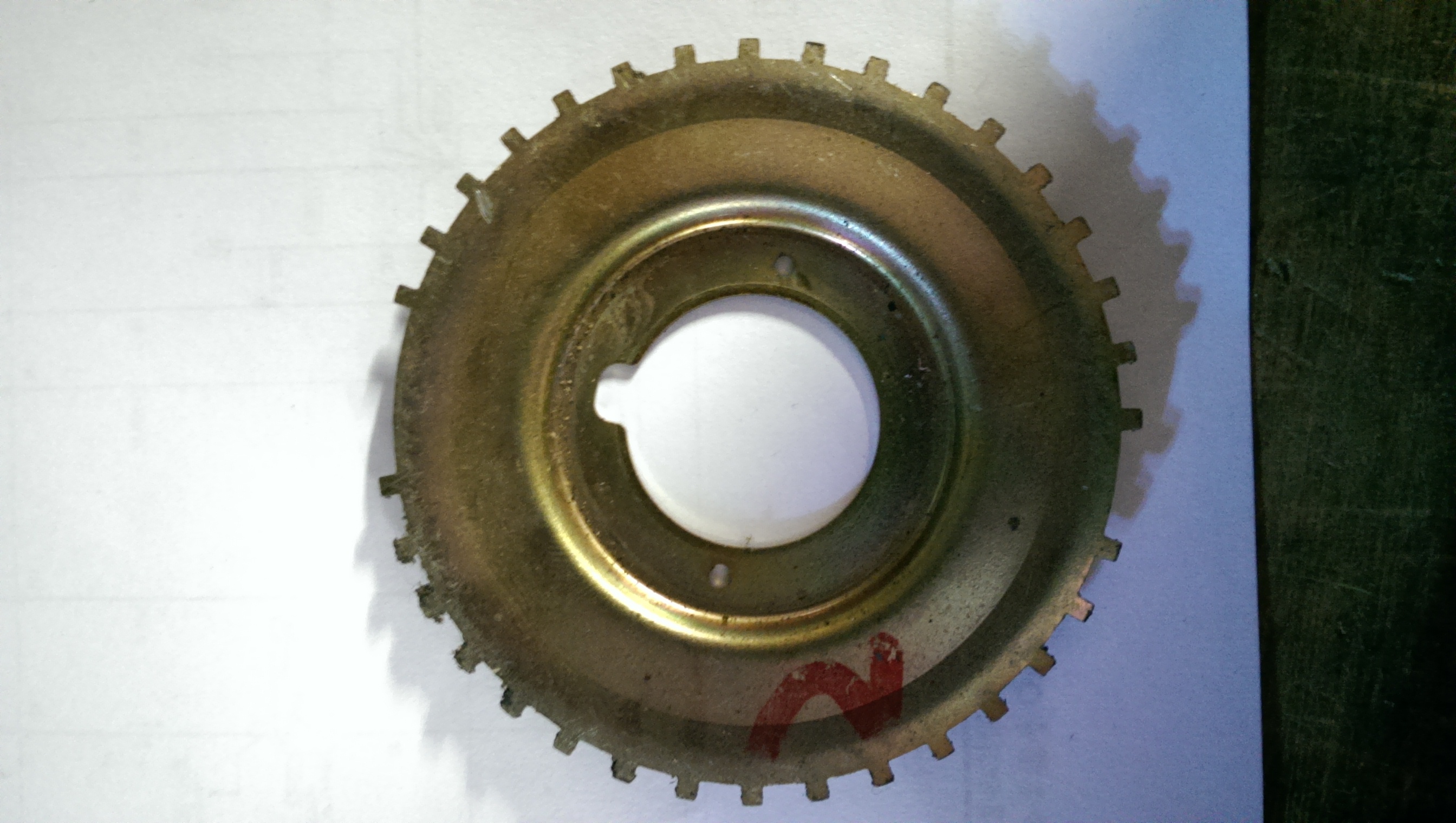

The EMU is fully connected up now, but it won't fire up. It cranks + fuel pump is comming on, but it just wont fire up.
I think its due to my trigger wheel setup. which am I supposed to use here? and do I need to enable the Cam Sync?

Re: Help wanted on this one!
Is this from crankshaft ?
The trigger wheel is untypical 17-1-16-2
We can add this type of trigger wheel but for the end of the next week due to tight work schedule.
What I need is EMU scope trace of primary trigger.
This trigger wheel can be used without cam sync (only wasted spark).
With cam sync you can run with full sequentianl fuel and ignition.
yep, its from the crankshaft.
the odd thing is I don't get any figures on the EMU scope display.
Reading is done by a Hall-sensor. So I've got
- 5V+ power supply
- Sensor ground
- signal wire to ECU
RPM is given on the gauge on laptop, but no scope signal.
is this all due to the wrong trigger setup?
MexicoMK1 wrote:yep, its from the crankshaft.
- 5V+ power supply
- Sensor ground
Go in under primary trigger settings and activate scope and enable pullup.
Post your settings. Are you pressing the " Get scope data " while you are cranking?
Now finally sorted out the crankshaft signal.
this is the signal from the crankshaft sensor that was pictured above + camshaft signal is also included.
what kind of Cam-sensor setup should I select from the secondary trigger menu?
hope this helps
hope this helps
We will add support for this trigger.
I would like to inform we have added the Colt trigger suport and actual tests looks very promising (I mean everything works ok
