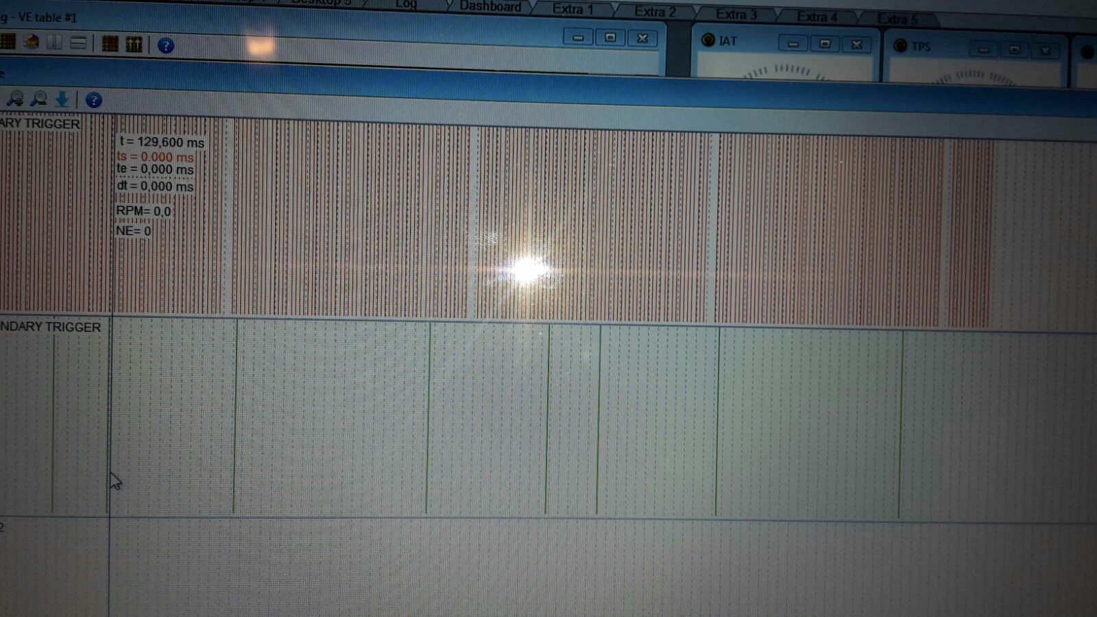

I want to run a Golf 4 V6 (engine code: AQP) in full sequential ignition and injection mode.
For now the engine runs in wasted spark and semi injection.
What cam sensor I had to configure to run the engine in full sequential? R32?
Does anyone know, how to configure the VVT option for the Golf4 V6 engine?
Here is a scope: Thank you for the help!

Try R32 4 teeth
Re: Golf 4 V6 full sequential and vvt
Thanks for the answer.
I already tried the r32 4 teeht, but it didn't work, therefore I configured wasted spark.
Is it falling or rising?

try both edges, but Your edge seems to be selected correctly.
Can you make scope with different edge ?
I have tested rising and falling edge and nothing works.
In the attachments are the 2 scope logs with falling and rising edge and the whole config of the emu.
The V6 AQP has just one cam sensor and one variable cam, is this the problem? Because R32 and V6 BDE have two cam sensors and two variable cams.

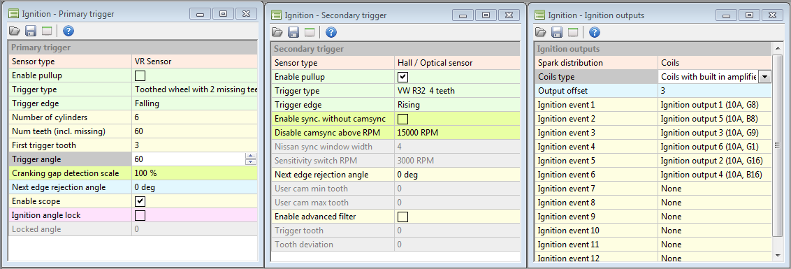

Try this setting! Maybe the ignition output offset will changed.
Best way to test it, try my setting and look if the Emu will synchronized during starting. When Emu ignition state goes in synchronized then you can test with the ignition test lamp if the cylinder firing order is correct.
What type of VVT is used in the AQP, the impeller adjusted one or the chain tensioner one?

Ok rising on the secondary is correct
I would set the secondary trigger to " User Defined" then set user cam min tooth to about 12 and the user cam max tooth to about 22
That looks like it should work you might have to play with the ignition output offset or the sequence
topic here about dialing it all in
http://www.forum.ecumaster.com/viewtopi ... anos#p2567

Sorry a little bit late, but I have tested the vvt with parametric output and the cam sync.
When I dont activate the vvt, then the turbocharger comes about 1000 rpm later. I think it really helps!
The solution for cam sync was, like jan32 and jadzwin wrote it, to set the secondary trigger to N+1 and the offset to 3! Thank you!
