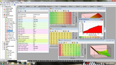

my settings on my 1jzgte and holset hy35.
while engaged, the idle is between 1200-1400rpm. manifold vacc is around -0.1bar. I keep my tps trigger low so that its a little easier to drive at low speeds without triggering the ALS. at lower rpm shifting, the ALS is adequate. at high rpm, there still isn't enough airflow coming through the IACV so fuel will load into the exhaust and backfire on longer intervals with much larger bangs and bigger flames. I do not like this because its much more violent and less productive. but shifting around 3500rpm, the ALS works perfect. enough bangs and enough turbo speed that low rpm boost comes back very fast.
