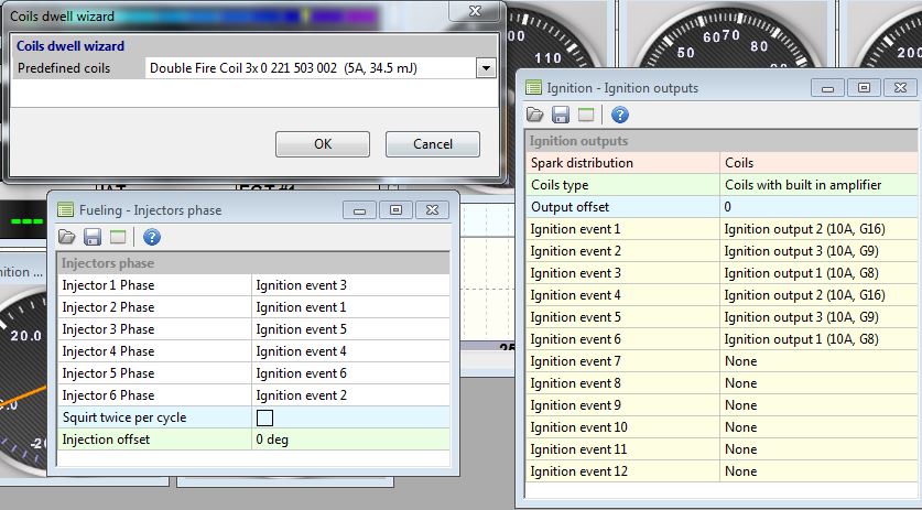

having trouble with my emu and getting setup
says inactive
injector and coil phase
153624 in that order for both
iacv not hooked up
550cc denso injectors
can someone help me setup a base map for this thing :D

This is the ignition outputs and injector outputs I'm using, set at 10deg BTDC too. Your setup will depend on what coil setup you are running too, so check the coil wizard. here is a map with oem VVTI coils, set as wasted spark

got my jz to run and idle
seems like the ignition and coil pack order was wrong,
i had it set 153624 life the firing order and some timing settings were wrong
