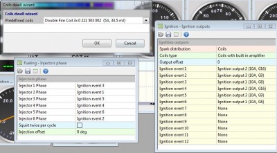

Scooter - Posts:44
- Joined:Thu Nov 12, 2015 3:08 am
Post
by Scooter » Tue Dec 15, 2015 3:22 am
This is the ignition outputs and injector outputs I'm using, set at 10deg BTDC too. Your setup will depend on what coil setup you are running too, so check the coil wizard. here is a map with oem VVTI coils, set as wasted spark

Santi253 - Posts:2
- Joined:Sat Dec 12, 2015 1:47 pm
Post
by Santi253 » Wed Dec 16, 2015 4:01 am
got my jz to run and idle
seems like the ignition and coil pack order was wrong,
i had it set 153624 life the firing order and some timing settings were wrong
thanks for the help
